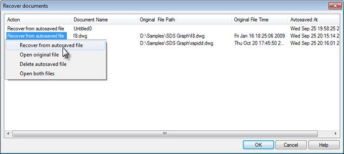

The first launch of nanoCAD after a failure starts from the Recover documents dialog box, containing information about the original file (name, path and creation time) and last autosave time.
To recover document data, click on the file name and select one of the following in the context menu:
Recover from autosaved document
Open original file
Delete autosaved file
Open both files

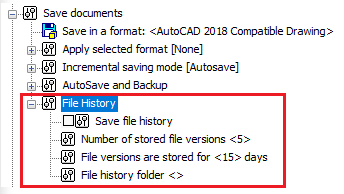

In this case you should enable and configure the save file history mode. It is based on the mechanism of autosaving files and is configured in the Options dialogue box – Section Save documents – File history:
- Save file history (FILEHISTORY variable) – whether maintain autosave history or not (0 – disabled or 1 – enabled);
- Number of stored file versions (FILEHISTORYMAX variable) – maximum number of autosaved file versions;
- File versions are stored for <> days (FILEHISTORYDURATION variable) – period of storing autosaved file versions in the storage (in days).
- File history folder – folder for storing autosaved copies.
