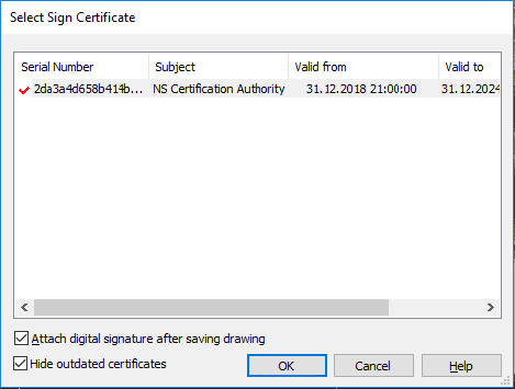

First you should set EDS certificate;
- in the current document open Attach digital signatures command DIGITALSIGN;
- in the opened dialogue box check the red flag of the required certificate;
- check the flag Attach digital signature after saving drawing.
When saved, the signed file getssign.
