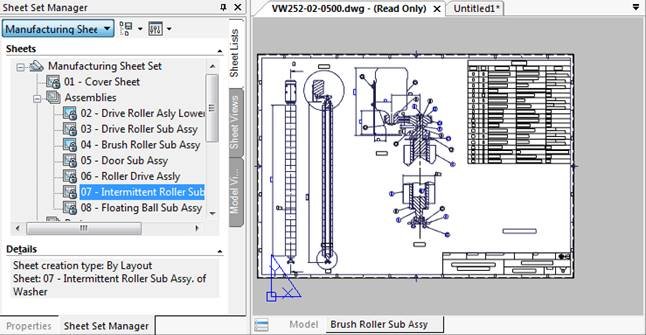

In the first tab of the Sheet Set Manager any set of layouts gets the tree and layouts distribution between the subsets.
Double-click on a layout name to open this layout from the corresponding file.

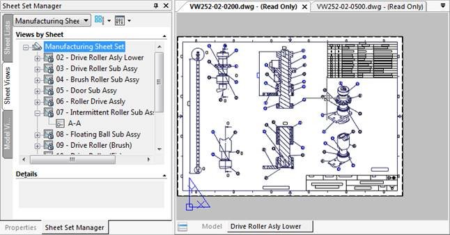

The second tab (Sheet Views) displays layout subsets and layouts with the used named views.
Click on a view name in the second tab to open this view from the corresponding file.

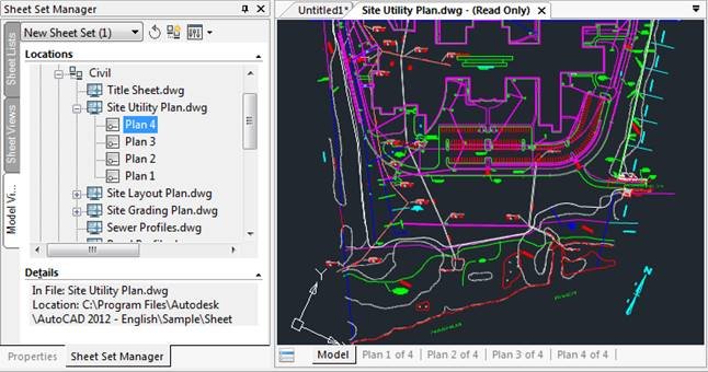

The third tab (Model Views) contains paths to the drawing folders and names of files with model views.
Double-click on a view name loads the corresponding file, switches to the Model tab and sets the selected view in it.
