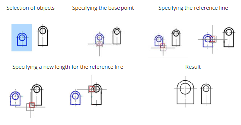

This command is used to decrease or increase the size of the selected objects whilst retaining their proportions (the scale factors along the X and Y axes are identical). If the scale factor is more than 1, the objects are increased in size; if it is less than 1, they are decreased.
| ? | Opens the additional options to select objects. |
| Copy | Scaling copy of the selected objects. |
| Reference length | Scaling the selected objects towards the reference line whose length is a single scale factor and a new length for the reference line. |
| Points | Scaling the selected objects towards the reference line whose length is a single scale factor and a new length for the reference line, specified by two points. |
| Select objects or [?]: | Select objects. Press ENTER when the selection is finished. |
| Specify base point: | Specify the base point. |
| Specify scale factor or [Copy/Reference length]: | Select the Reference length option. |
| Specify reference length: | Specify the first point. |
| Specify second point: | Specify the second point. |
| Specify the new length or [Points]: | Select the Points option. |
| Specify first point: | Specify the first point. |
