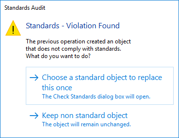

After the warning appears, you can choose to correct the violation or ignore it.
If you choose to fix the violation, the Check dialog box opens. If it is not required to fix the violation, select Save non-standard object, when the alert appears.
Each detected violation can be fixed or ignored. Information on each detected but not fixed standards violation is saved in the drawing. You can turn off the display of information on such ignored objects the next time you check the drawing.

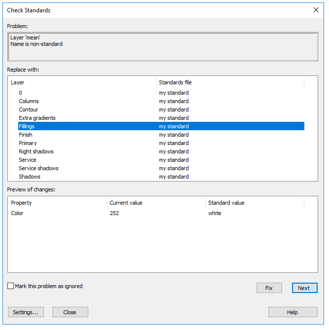

If there is no preferred fix option for the current standards violation, there will be no options highlighted in the Replace with list, and the Fix button is not available.

Detected elements with nonstandard names are purged from the drawing. All objects associated with the nonstandard element are associated with other element, which replaces that being purged. For example, when detecting a nonstandard layer Wall, it can be replaced with the standard layer Arch-wall. In this case, in the Fix mode of the Check dialog box all objects from the Wall layer are transferred to the Arch-wall layer, then the Wall layer is purged from the drawing.
If in the Check dialog box the Mark this problem as ignored is flagged for the detected violation, then notifications on detected violations related to this named object will not be displayed in future.
Once the entire drawing has been audited, the Check complete message is displayed; it reports all standards violations found in the drawing, as well as the details for violations: fixed automatically, fixed manually, ignored.
