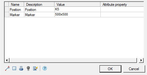

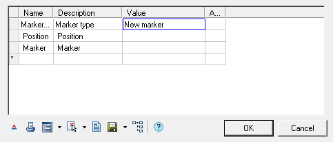

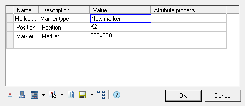

The “Creation of a marker” dialog box appears. The properties table will list the attributes entered in the callout text boxes:
Column “Name” contains the working name of the attribute.
Column “Description” describes the attribute.
In column “Value” the values of the attribute are entered. Values can be either numeric or text. Auxiliary commands are available in the context menu of the “Value” column.

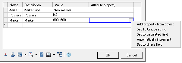

Column “Attribute property” is used to indicate the type of the input attribute. Various attribute labels are provided to indicate their type. The default is “Set to simple field”.
Attribute types:

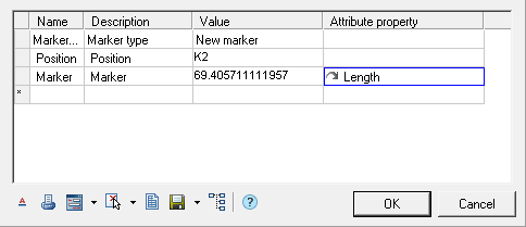

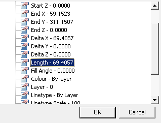

Add property from object – allows you to set an attribute value by associating it with the attribute value of another object in the drawing.
Important! An object is understood as an object from the base of standard products.
After choosing the type, it is suggested to select the object and the object attribute.
After selecting an attribute, its value falls into the “Value” column, and in the “Attribute property” column the name of the selected attribute.
After assigning an attribute, you can change the type of relationship with an object attribute:
One-way communication – changing the value in an attribute of an object affects the value of the marker.
Two way communication – changing the value in the marker affects the attribute of the object, and vice versa.
Basic communication – an attribute of an object can only be changed from a marker. If the attribute is a table value in a basic relationship, the closest value from the table is displayed. The entered value will be displayed in brackets.
Set To Unique string – allows you to set a counter attribute that will increase its value by 1 for each subsequent inserted marker. In the “Value” column for the visible counter attribute, you can specify a character string – a prefix. In the drawing, the counter value will be appended to the prefix.

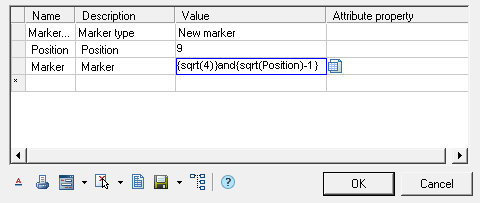

Set to calculated field – allows you to set the value of an attribute using a mathematical expression, using references to other marker attributes, operators, and mathematical functions. The name of the desired attribute is used as a reference to another marker attribute.
Note: Computed attributes are defined and calculated from top to bottom.
Important! Calculations are performed in curly braces.

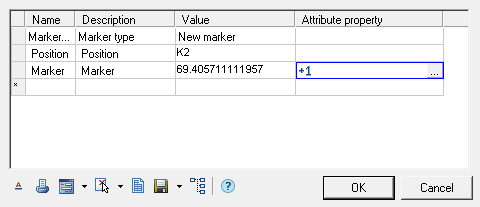

Automatically increment – allows you to set a counter attribute that will increase its value by 1 compared to the same attribute of the previous inserted marker. Such a counter attribute allows repetition of the same values for several markers, which distinguishes it from an attribute set to a unique value.

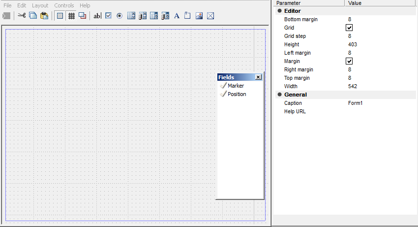

“Show form editor”- calls the custom form editor to create a dialog for working with marker attributes.
The following commands are available in the drop-down menu:
“Edit Form”. Open Form Editor.
“Add Form. Adds additional forms, while the marker can change the appearance of the form, by condition or by the user’s choice. By default, the marker has one form.
The form editor uses standard Windows form generation technology. The toolkit consists of three blocks – the graphic editor area, the toolbar with form objects and the properties window of the inserted elements. For inserted fields, the “Field Name” (“Variable”) can be selected from the list of existing marker description fields. In this case, the default field valu e is equal to the field value in the marker description.
When adding a second form, you are prompted to enter a name for the form. The variable Tag – mcFormName is added to the properties table. This variable is responsible for the name of the form, it can be set in a calculated field and, for example, made equal to execution. Empty or “Main” is considered the main form.

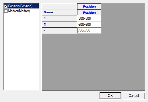

“Set parameters table”. Opens the marker parameter table editor. When inserting a marker and having a table of values, it is possible to assign a group of values to the marker attributes.
In the list, select the parameters whose values will be selected from the table. In the right part of the window, enter the required number of lines with values. Close the dialog with the “OK” button.

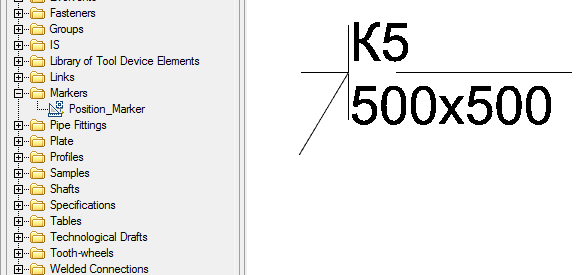

For future use of the marker, save it to the database as a named object.
In the “Create element” dialog box, specify the path to save, the name of the object and the note (for more information on working with the object base, see the nanoCAD Construction 25 Object Manager). After you save the marker, a message appears prompting you to update the existing copies of the marker in the drawing.
nanoCAD Construction makes it possible to immediately apply the created marker. The command line prompts you to install the generated token. Pick an insertion point in the drawing. Identical markers can be simply copied in the future. In other cases, the marker is inserted directly from the base.
