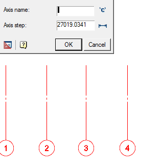

In the dialog box Single axis indicate the number of the first axis inserted. Click OK.
Specify start point or the name of the first axis.
Specify the endpoint of the first axis.
Enter the distance to the next axis or the insertion point. Complete the cyclic command by pressing Esc.
When you enter the distance from the keyboard position of the axis the current cursor position is given.

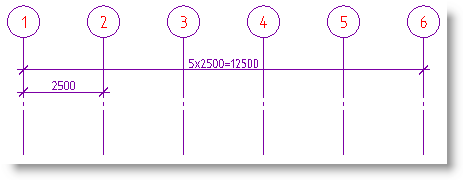

Switches Dimensional chain and total size includes automatic dimensioning between the axes. Dimensions may be linear or angular.
Dimension grouping joins chain of dimension into one single group dimension.

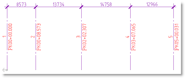

Switch Stationing displays stationing dialog.
Stationing can be chosen from a list of PC or CM. You can also specify the number of the first picket. You can set the initial value, enter it in the appropriate input box.
Stationing is calculated as the ratio of the actual distance between pickets to the specified distance in meters plus supplement.
At a given distance between pickets 10m axis will be as follows:
Anchor shows the direction of reference between the axes.

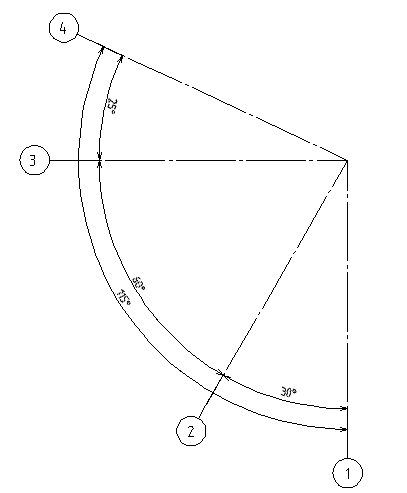

A-angle translates insert axis in append mode radial axis
