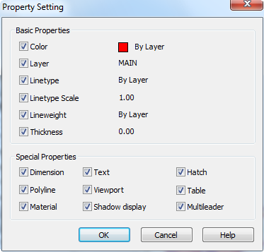

The Settings option opens the Property Settings dialog box where you can specify the copied properties from the source object:
Parameters:
Basic properties
Color Switches on/off the color copying mode.
Layer Switches on/off the layer copying mode.
Linetype Switches on/off the linetype copying mode.
Linetype Scale Switches on/off the linetype scale copying mode.
Lineweight Switches on/off the lineweight copying mode.
Thickness Switches on/off the thickness copying mode.
Special properties
Dimension Switches on/off the dimension style copying mode.
Polyline Switches on/off the width and type of polyline copying mode.
Material Switches on/off the material copying mode.
Text Switches on/off the text style copying mode.
When copying a note properties, if the Text checkbox is unchecked, only the text style of the note will be copied, without the text itself.
To copy note properties without copying the text content, you can also use the
Viewport Switches on/off the viewport properties copying mode.
Shadow display Switches on/off the shadow display copying mode.
Hatch Switches on/off the hatch properties copying mode.
Table Switches on/off the table style copying mode.
Multileader Switches on/off the leader note style copying mode.
NOTE: When copying leader properties from the menu Draw > Mleader, there is one feature:
• if the Text box is checked, then in addition to the text style, the leader text itself is copied;
• to copy properties without text, clear the Text checkbox.
You can also copy leader properties without copying text using the Match properties button in dialogs of creating/editing leaders.
