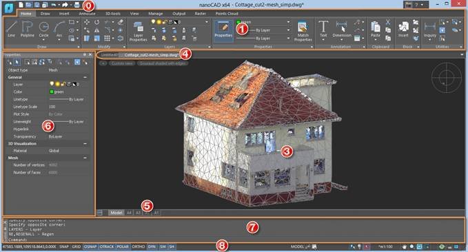

With nanoCAD you can organize user workspace according to the user’s needs and tasks. The standard set of tools is usually used:
Ribbon interface:
Classic interface (with main menu and toolbars instead of ribbon):
The nanoCAD workspace consists of the following interface elements:
- the nanoCAD button and the Quick Access toolbar (0);
- ribbon or main menu (1);
- toolbars (2);
- drawing window (drawing area) (3);
- documents’ tabs (4);
- document layouts’ tabs (5);
- Properties bar (6);
- command line (7);
- status bar (8).
