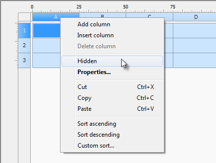

In the Properties dialog box of the column switch is available Hidden. With it, you can disable the display of the selected column in the drawing, however, the Editor will be displayed.
You can also hide a column from the context menu for the column.
