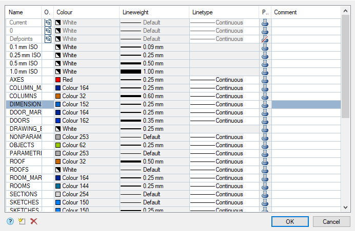

You can also use the “Table of layers”. The “Table of layers” is called by the button or by selecting the
In the dialog box “Table of Layers” a list of the layers available for use is given.
the symbol in the “On drawing” column indicates the layers that are present in the current drawing.
Button “New Layer” adds a new layer to the table.
Button “Delete Layer” removes the selected layer from the table.

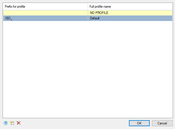

To add and edit profiles, use the button in the parameter line “Settings – Main options – Common settings – Current profile”.
In the dialog box “Table of profiles” lists available profiles.
Button “Add profile” adds a new profile to the table.
Button “Delete profile” removes the selected profile from the table.
Add a profile, select it in the table and close the dialog box by clicking the “OK” button. Close the “Settings” dialog box.
When inserting objects nanoCAD Construction to the special layer, a prefix corresponding to the current profile will be added to the layer name.
