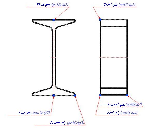

function SetGripPoint { // At four I-beam handle NGrip = 4; // Handles are situated at the extreme points of the model I-beam // The insertion point pntGrip0 = pntOrigin; // On the opposite end pntGrip1 = pntOrigin + L * vecDirection;
// At the midpoint of the top shelf pntGrip2 = pntOrigin + h * vecPlane; // At the extreme point of the bottom shelf vecNormal = getLocalNormal (vecDirection, vecPlane); pntGrip3 = pntOrigin + vecNormal * b / 2; };
function OnMoveGripPoint { // The first carrying handle entire I-beam if (NMovingGrip == 0) { pntOrigin = pntGrip0; };
// The second handle stretches the length of the I-beam and determines // Direction vector insertion I-beam if (NMovingGrip == 1) { L = max (vecLen (pntGrip0 – pntGrip1), 1); vecDirection = pntGrip1 – pntGrip0; LoadInCache (seria, h, b); SelectInCache (“kFirst”, “seria”, ““, “20”, “h”, “”, h, “b”, “~”, b); }; // Handle height of an I-beam // At its height stretched selected new I-beam, // Roughly equal relative distance from the cursor point // Insert parts. if (NMovingGrip == 2) { // Auxiliary variable height of the new I-beam. rNew_h = vecLen (pntGrip0 – pntGrip2); LoadInCache (seria, h, b); SelectInCache (“kFirst”, “seria”, ““, “20”, “h”, “”, rNew_h, “b”, “~”, b); }; // Handle I-beam flange width // If it is stretched selected new I-beam flange width, // Approximately equal to twice the relative distance if (NMovingGrip == 3) { // A new auxiliary variable distances. rNew_b = 2 * vecLen (pntGrip0 – pntGrip3); LoadInCache (b, h); SelectInCache (“kFirst”, “b”, ““, rNew_b, “h”, “”, h); };
