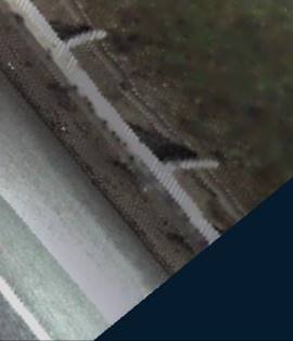

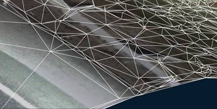

Mesh before the texture overlay

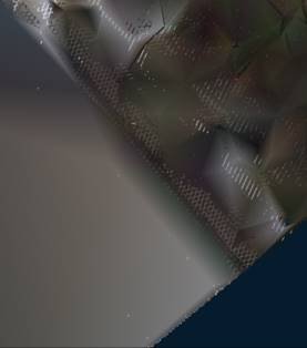

After removing the point cloud from the drawing, the surface preserves the texture:
