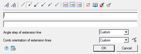

If the option “Show dialog before inserting objects” is active, the “Comb leader note” dialog opens. In the “Comb leader note” dialog box, enter text and define the note options. Click “OK”.

If the “Show dialog before inserting objects” option is disabled, the “Comb leader note” dialog will open.In the “Comb leader note” dialog box, enter text and define the note options. Click “OK”.
Note will be build.
- Multi-line text – the switch controls the display of multi-line text on the shelf;
- Frame – text under the shelf is framed;
- Type arrows:
- None,
- Arrow,
- Point,
- Open arrow,
- Half-arrow,
- Oblique;
Align text horizontally; - By left edge
- By center
- By right edge
Insert special symbol – the command allows you to insert a special character into the input field;
Notebook – the command allows you to insert data from a notebook into the field;
Match properties – command copies appearance parameters from another object;
Add extension line – the command allows you to add an additional note line;
Global options – note settings.

Fields
Comb leader note by default contains: two lines of input, a list for specifying the pitch of the angle of inclination and the orientation of the ridge.
The first line is for the label above the leader shelf, the second is under the leader shelf.
In the “Angle step of extension line” list box, the slope angle of the leader lines is selected:
- Custom – a leader line is placed arbitrarily (default);
- step 15° – the leader line is put down with a step multiple 15°;
- step 30° – the leader line is put down with a step multiple 30°;
- step 45° – the leader line is put down with a step multiple 45°;
- step 90° – the leader line is put down with a step multiple 90°.
In the “Comb orientation of extension lines” list box, you can select the ridge orientation of the leader lines:
- Custom;
- Horizontal;
- Vertical.
The list is equipped with an additional button “Select line”, which allows you to select the direction of the ridge of the leader lines parallel to any line segment in the drawing.
The “Multi-line text” option allows you to display multiline text on the shelf. When this parameter is enabled, the transition to another line is performed by the “Ctrl + Enter” key combination.

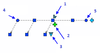

Grips
1. Text alignment toggle grip.
2. Leader lines grip.
3. Arrow type switch-grip.
4. Ridge line rotation grip.
5. Shelf rotation grip.
