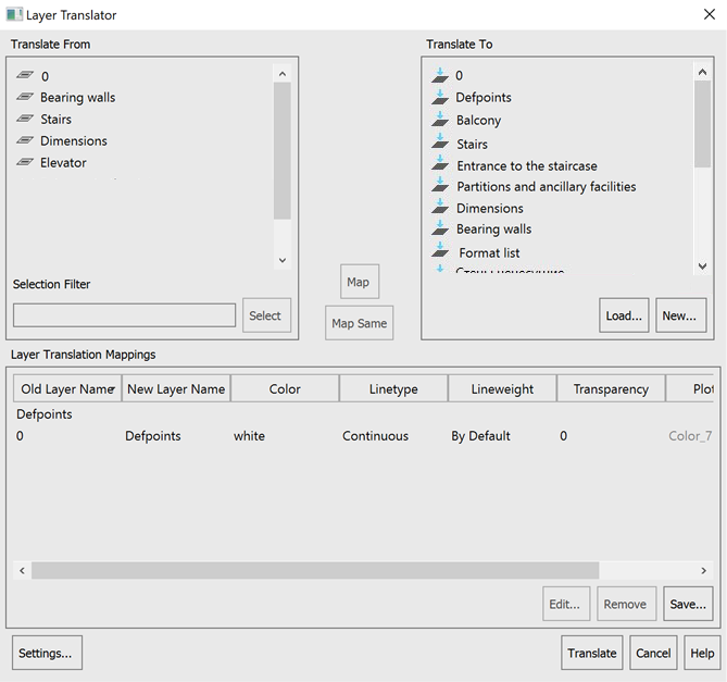

The command opens the Layer Translator dialog box:
Options
Translate from Selecting a layer to convert from the list of all layers in the current drawing.
To select several layers, press and hold the SHIFT key; to add any layer to the selection, select while holding down the CTRL key.
You can also add layers to your selection using the Selection Filter.
All layers in the list are selected using the Select All context menu command. The Deselect All command deselects all selected layers in the list.

Selection Filter Using a filter to select layers from the Translate from list. You can use special characters in the filter.
Select Adds filtered layers to the selected layers in the Translate from list.
Translate to
Load… Loading layers into the Translate to list from a drawing (.dwg), template (.dwt) or standards file (*.dws).
If the downloaded file already contains a Layer Translation Mappings table (files created using the Save… button), then this information will be displayed in the Layer Translator window.
You can load layers from multiple files into one drawing.
When loading files with same name layers, the layer loaded first is included in the Translate to list. Likewise, the loading of a mapping table element is canceled if it matches one in the drawing.
New… Creates a new layer in the Translate to list.
If you select a layer in the Translate to list before clicking the button, the properties of that layer will be used by default for the new layer.
Map
Matches layers from the Translate from and Translate to list and adds them to the Layer Translation Mappings table. Adding is also done by double-clicking on a layer (from or to).
Map same
Matching layers that have the same names.
A tabular preview of the list of layers to be converted and the list of properties they will receive: New Layer Name, Color, Linetype, Lineweight, Transparency, and Plot Style.

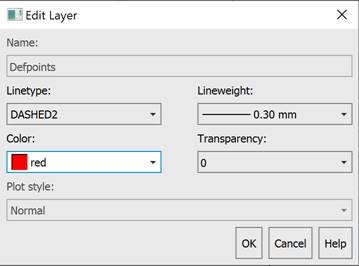

You can edit the properties of the destination layer in the Edit Layer dialog box.
Edit… Opens the Edit Layer dialog box, where you can change the properties of the destination layer: Color, Linetype, Lineweight, Transparency, Plot style.
You can also open the Edit Layer dialog box in the Layer Translation Mappings table by double-clicking on the mapping or by using the Edit context menu command.

To translate drawing layers according to specified standards:
  • Run the command.
  • In the Translate from list, select the layers to translate. If necessary, use the Selection Filter.
  • Click the Load… button to load destination layers from a drawing, template, or standards file. Or click the New… button to create a new destination layer. In the Translate to list, select the layer whose standards will be used for translation.
  • Click the Map button and check the data in the Layer Translation Mappings table. If necessary, repeat the layer selection to set other mappings. To map layers with the same names, use the Map Same button. To edit destination layers, click the Edit… button or select the Edit context menu command. To remove mappings from the table, click the Remove button or use the Delete, Delete all context menu commands.
  • If necessary, click the Save… button to save the mappings.
  • Click the Settings… button and select layer translation settings.
  • Click the Translate button to start the process of translating drawing layers in accordance with the specified standards.
