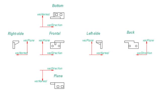

Placement of graphic
The separate details and the separate implementations of one GOST should be separated from the other GOSTs and implementations in the drawing (zonally or with the rectangular frames). If there is more than one GOST or implementation, the GOST number or implementation name should be written above of the group of implementation or GOST views.
The views should be in the projective connection in the drawing.
Figure 1. Placement Drawing Views.
The views, which are out of the projective connection, should have clear names to define the relation.
It is recommended to group the views with cuts, simplified views and views with dimensions near their projective views.
If one or several views belong to one GOST/implementation, they should have clear names to define the relation (for example: “Left-side view (all implementation)”, “Frontal (GOST 7798,7805, 7806)”). The graphic of the details view should have a name.
The detail should be oriented that the detail’s direction (vecDirection of script) should coincide with the OX axis (to the right for the frontal view).
