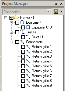

Project Manager is a functional panel that controls all of the engineering networks (equipment, port, trace).

Add new Network
Adding a new network is calling the command “Create New Network” from the context menu function bar “Project Manager”.
