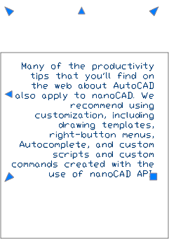

MTEXT after applying the BR (Bottom Right) alignment with the JUSTIFYTEXT command: ![]() |
TEXT view when you set the Right justification type in the Properties panel ![]() |
MTEXT after applying the BR (Bottom Right) alignment with the . TJUST command: ![]() |
