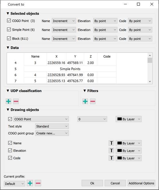

The command converts point objects: points to geopoints and blocks, blocks to points and geopoints, geopoints to points and blocks.
Selected objects The section defines which types of point objects selected in the drawing should be converted to another type and where to get values for mark labels.
You can convert geodata simultaneously from all or selectively from the following types of point objects:
  • Simple objects of the Point type with mark labels in the form of ordinary text objects;
  • Block insertions with single-line attributes as mark labels (for example, conventional signs inserted into the drawing as blocks from the Conventional Signs toolbar);
  • COGO Point type objects with a label.
    Values for labels can be taken from the increment, attributes of the point itself, or from the text object nearest to the point:
    If you select By point, you will need to specify from which attribute of the point the information should be taken. The list will show the existing attributes of the geopoint or block:
    If you select Nearest text, you will need to specify the maximum distance from the point to the text object at which this text will still be considered the label of this point:
Data The table typifies and edits the data obtained from point objects: point coordinates by X, Y and Z, numbers, descriptions of points. The column heading displays the data type. In case of incorrect initial data typing, you can drag one header to another, thereby mutually changing them.
You can delete selected cells, rows, or columns. Multiple selection is supported using SHIFT and CTRL. Rows or columns are selected by clicking on the heading. Before manually deleting data, it is recommended to filter it out using filters.
You can also edit the data after double-clicking on a cell.
UPD classification You can add custom properties to points with the button. You should specify the type (integer, float, or string) and name.
A new empty column with the name of the custom parameter appears in the Data table. Drag this column heading onto the heading of the column you want it to match.
Filters You can exclude data from conversion not only manually by deleting cells from the Data table, but also by setting filters. For example, you can exclude from the conversion all points with heights below 52 (column Z) and with a number greater than 350 (Name column).
After adding the filter with button, in the drop-down list, select the column by which all converted data will be filtered. Then set the value the column data should satisfy. The rest of the lines will be excluded from conversion. Hovering over a filter displays a tooltip with sample values.
It is recommended to set filters only after correct data typing in the Data section.

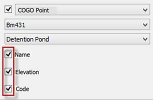

  • Objects of Geopoint type with a label.
    In case of data conversion into a Geopoint object, you should specify a group for them below, in the drop-down list of groups.
    The list contains only groups of geopoints that exist in the current drawing. To create a new group, select the Create new option and enter a name for the new group.

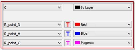

    You can specify which labels will be displayed in the geopoint label on the drawing: name (geopoint number), elevation (Z-coordinate) and code (point description).
    Individual layers and color can be assigned to place points and labels.
    Labels can be assigned with a font.
