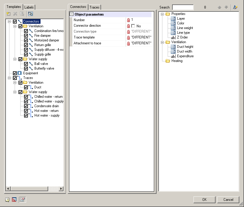

Form template library is required to work with templates of engineering networks (add, edit, delete) and consists of three parts: a panel of wood patterns, the list of designated parameters, the panel attributes.
Tree patterns
Tab templates
Tree patterns is divided into 3 main sections: ports, traces and equipment. In each section of the corresponding templates are added.
Switch notes whether the pattern present when editing the parameter list. When the level of several patterns of one type, the parameters will change them together.
Each type of template tab gets its parameter list.

Adding template
The “New template” adds a new template is selected in the tree section.
When you run the command, the creation of a form of the element, which you must specify the location to save the template in the database elements, name, note and confirm.
The new template is added to the appropriate section.

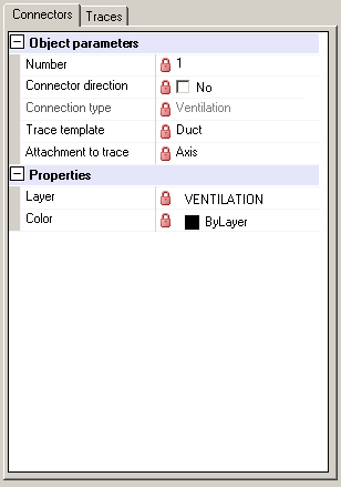

Parameter List
The parameter list contains the settings of the selected template(s) and allows them to edit.
The parameter list is divided tabs: Connectors, Traces, Equipments. Each tab displays the parameters of ports, traces, equipments, respectively. Options ports belonging to the equipment are displayed on the “Connectors”. All three tabs are similar.

Panel attributes
Panel attribute contains additional parameters that may be added to the list of parameters by gripping and handling.
The panel is a two-level tree. The first level of the section, the second – the attribute.
If the panel does not need attributes, you can turn to the “attributes panel” (in the lower left corner of the form).
