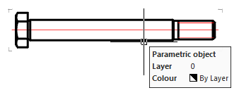

Allotted object
An object is considered allotted (indicated) if additional graphic information appears on the screen when the mouse cursor is moved to it:
  • the object is highlighted in color;
  • the “rectangle corners” of the object appeared;
  • the object information tooltip appeared.
Note: The mouse keys are not pressed in this case – you just hover the cursor over the object.
Scaling to the allotted object
Move the mouse pointer over the nanoCAD Construction object until “rectangle corners” appears, the object color changes, or an info tip appears;
Hold down the SHIFT key and press RMB. It will auto scale to the center of the screen.
