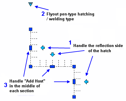

Button Side hatch allows you to select the direction of the hatch.
Change the direction of the hatch, you can select the “handle” the reflection side hatch:
