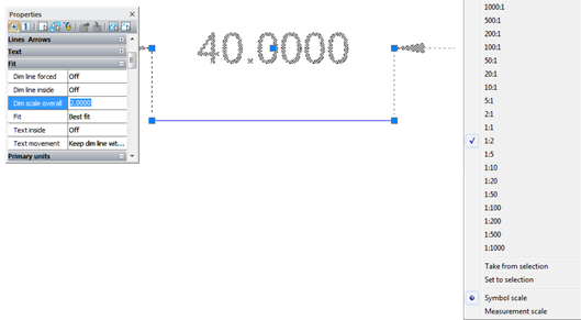

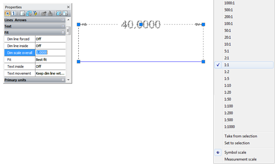

Symbol Scale
Symbol scale is a settings parameter which decreases or increases the annotation objects in the drawing. This scale type is used for adjusting the display of annotation if it is too small or too big; for example, to change the size of an object’s arrows and text. This scale has no influence on the size of other objects.
Symbol scale affects:
  • Annotation objects.
  • Linetypes with gaps and text.
  • Dimensions and special text.
    Symbol scale for objects is 1:1 Symbol scale for objects is 1:2
To set symbol scale:
To set and change scales, use the scale button in the status bar. If the value is set to symbol scale, the m character is in lower case
Example of changing the symbol scale of a dimension object:

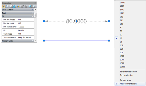

Measurement Scale
This scale influences objects, but the size of the annotation of the objects stays unchanged. Linear dimensions are also scaled.
Measurement scale can be set for the following objects:
  • Dimension objects; measurement scale influences the dimension text.
  • Special object from vertical applications can have influences on the measurement scale of an object size in the drawing.
Measurement scale for all objects is 1:1 Measurement scale for all objects is 1:2 Measurement scale for dimension objects is 1:2 and for object is 1:1
Use this scale if the drawing has a scale that differs from 1:1 scale.
To set measurement scale:
To set and change scales, use the scale button in the status bar. If the measurement scale value is set, the M character is in upper case: .
Example of changing the measurement scale:
