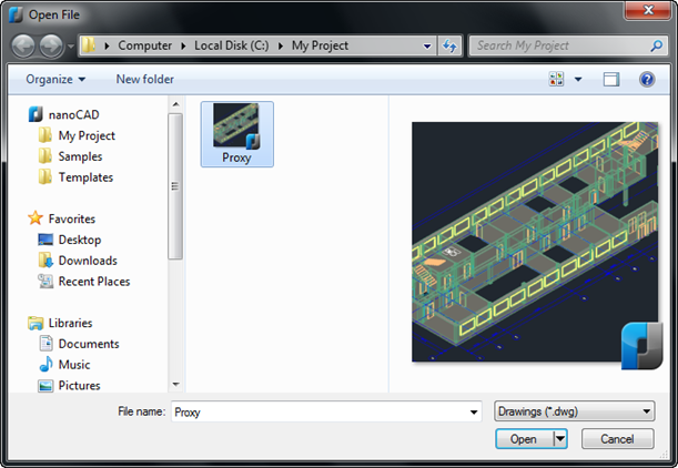

Opening a Document
nanoCAD button – Open
Menu: File – Open
Toolbar: Main–
Hotkeys: CTRL+O
Command line: OPEN, OPENDOCUMENT
Command opens the dialog to find and open the desired file.

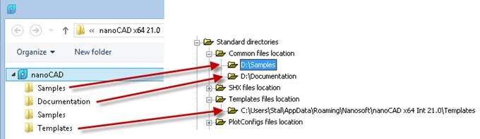

Note! Navigation pane in nanoCAD list displays only those folders that are specified in Standard directories section of the Options dialog:
To open a document, you can drag it into the working area of nanoCAD.

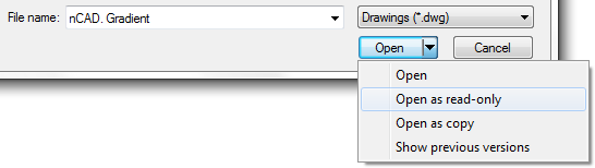

It is available to open document for reading or open as copy:
Open as read-only – Open the document for reading without editing.
Open as copy – Open the copy of document. Prefix Copy (N) added to the file name. N is number of copies.
NOTE: Assign new name for copied and read-only files to save changes.

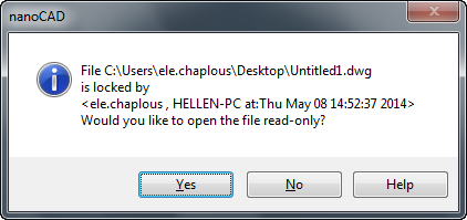

Documents Protection when Sharing

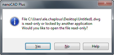

nanoCAD has mechanism protecting file against losing information when the file is opened by several users.
A message appears when user opens file that is open by another user or when file is read-only:
If the document is read-only, inscription Read Only appears in the document tab:
Only user who opened the file first can save the under the same name. Others receive message even if the first user closes the file:
Other users can save the file after reopen.

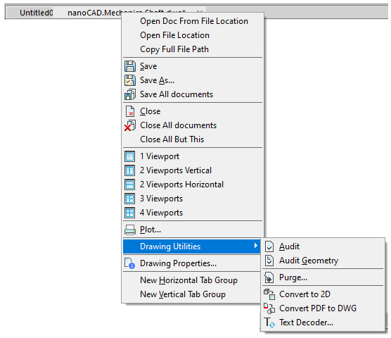

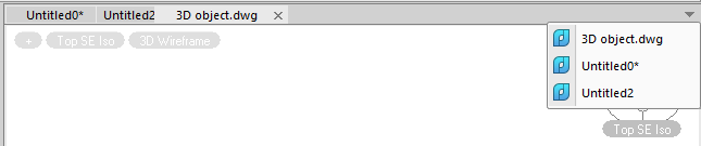

Working with Document Tabs
When many documents are opened, every document is opened in a separate window with a tab in the top part of the working area. To switch between them, select the tab or click the Active files button in the top right corner of the document window:
If you place the cursor over the document tab, a tooltip with the information about file location is shown:
The context menu permits the selection of display options for the documents:
Commands of the context menu:
Open Doc from File Location Opens file location folder.
Open File Location Opens file location folder in Windows explorer.
Copy Full File Path Copies full path of file to clipboard.
Save Saves a document.
Save As… Saves a document with a new name.
Save All documents Saves all opened documents.
Close Closes a document.
Close All documents Closes all opened documents.
Close All But This Closes all opened documents except the current.
Plot Prints a document.
1 Viewport Shows a document in one viewport
2 Viewports Vertical Splits document to 2 vertical Viewports.
2 Viewports Horizontal In Model space: Splits document to 2 horizontal viewports.
In Paper space: Creates 2 similar horizontal viewports inscribed to print area.
3 Viewports Splits document to 3 viewports.
4 Viewports Splits document to 4 viewports.
New Horizontal Tab Group Horizontal display of a tab in the working area.
New Vertical Tab Group Vertical display of a tab in the working area.
