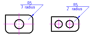

This command is used to create fillets in the intersection points of objects, with automatic dimensioning ability. The command can create fillets individually.

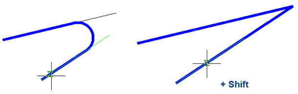

The Fillet command can be used for quick trimming or lengthening of selected objects. To do it, press SHIFT button when you select objects: a current value of fillet radius is temporarily changed to 0 and objects are lengthened or trimmed to intersection point.

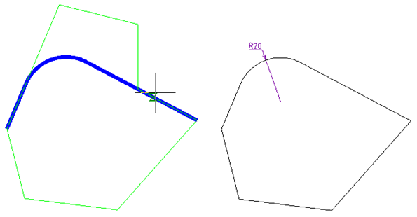

polyLine Switches to the mode of making fillets along a whole selected polyline.
If a fillet radius does not equal zero the command creates fillet arcs for every node, created by crossed line segments, if they have a length enough for fillet creation.

If you press and hold SHIFT when selecting the second object, then a corner will be formed (closing in the intersection point and cutting off).

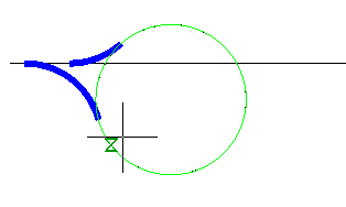

For pairs of objects LINE-ARC, ARC-LINE and ARC-ARC, two types of fillet are available: outside and inside ones.
A fillet that combines inside and outside tangency is additionally available for ARC-ARC pair.
NOTE: Availability of different types of fillet depends on the fillet radius. Outside and combined fillts require larger radiuses than for inside fillets.

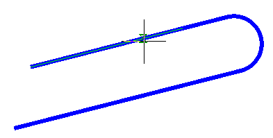

Selecting two parallel lines will create a fillet with a radius equal to half the distance between them (regardless of the specified Length). The sides will automatically align to the longest line.
Fillet of parallel lines also works for segments of the same polyline.

When making an insertion, a polyline retains its integrity.
If one polyline is formed of two polylines as a result of the command, then it will be a single polyline object.
If segments of one polyline separated by other segments are selected, then all these intermediate segments are deleted.
