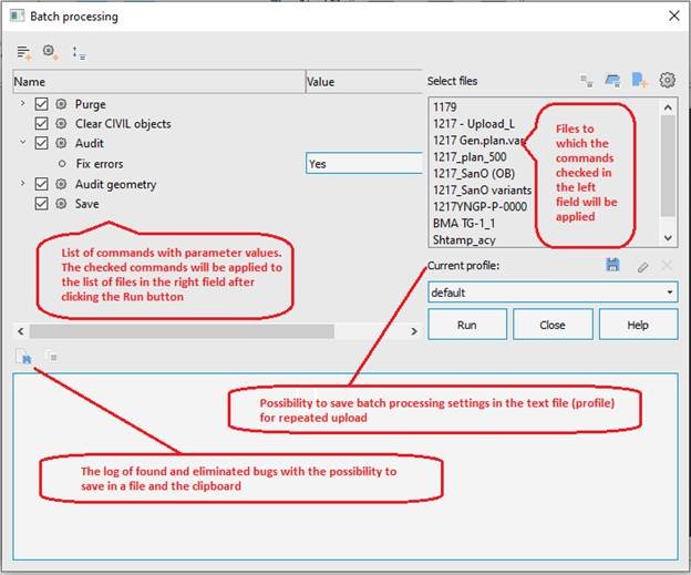

Upon running the command, the Batch processing dialog box opens.
The right field displays a list of files selected for processing. You can add files one by one using the Brouse file, or as a whole folder using the Brouse folder button. The Use current drawing button adds the current document to the list. In the Settings , you can specify the search in subfolders.
The left part of the Batch processing window contains a list of commands available for applying with a list of parameters. The flags mark the actions to be performed for each file from the list in the right part of the window. To add a new command manually, you can use the Add command button.
To change the order of commands, click the button and in the window that opens change the commands order by drag and drop.

Batch processing settings can be saved to a new settings profile for later use.
You can create a new profile with a clean list of commands using the New script button.
The batch processing is started with the Start button.
Messages about found and fixed problems are displayed in the central field.
Batch processing can be halted by the Stop button.
