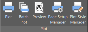

Draft output plotting remains relevant until the transition to electronic documents is complete. Being adept at plotting can save you time and effort. All the plotting-related functionality of nanoCAD is found in the Plot groupon the Output ribbon (Fig. 1).
Fig. 1: Plot group, Output ribbon
There aren't as many commands here as in the blocks section, but there are far more settings. Below we've provided a number of tips to bring some clarity to the settings and help you automate your plotting.

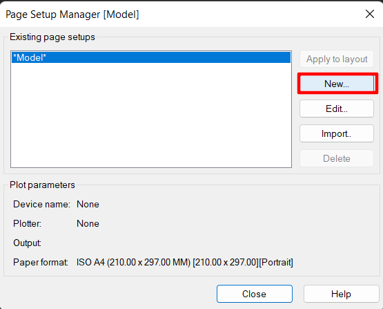

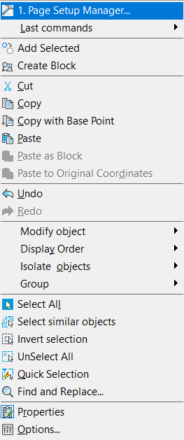

- open the Page Setup Manager (Fig. 2)
Fig. 2: Opening the Page Setup Manager
- Press New (Fig. 3)
Fig. 3: Operating the Page Setup Manager

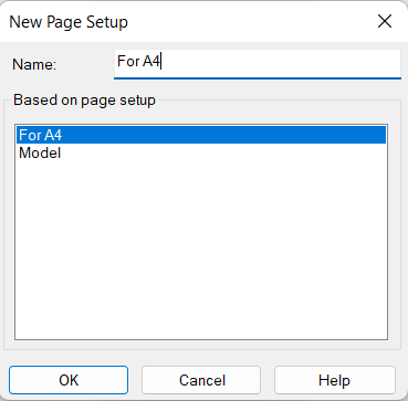

- enter a unique plot setup name (Fig. 4)
Fig. 4: New plot set

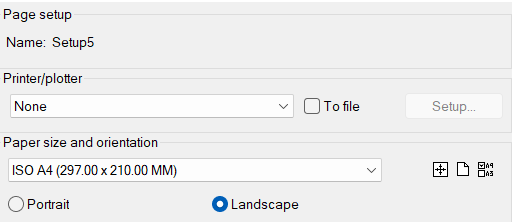

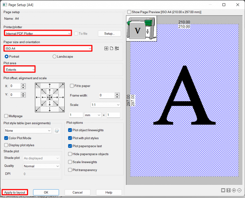

- Press the OK button. When the Page Setup dialog box opens, enter all the necessary settings for the current and subsequent pages, as shown in the example of Fig. 5.
Figure 5: Page Setup
- apply the settings to the layout by pressing the corresponding button in the bottom left corner of the dialog window (see Fig. 5).

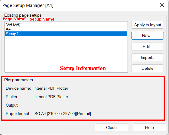

Figure 6: Result after the page setup is configured
In the Page Setup Manager, we can see the Page Name with the settings assigned (indicated in parentheses) - Fig 6. A single document can contain any quantity of setup configurations. Brief accompanying information is presented in the bottom of the window to avoid any confusion for the user.
To use the obtained setup in other pages, go to the Page Setup Manager (Fig. 7), highlight the relevant setup, and click Apply to layout.
Figure 7: Executing the Apply to Layout command
Applying the setup is handy when plotting two or more pages with the same configuration parameters.

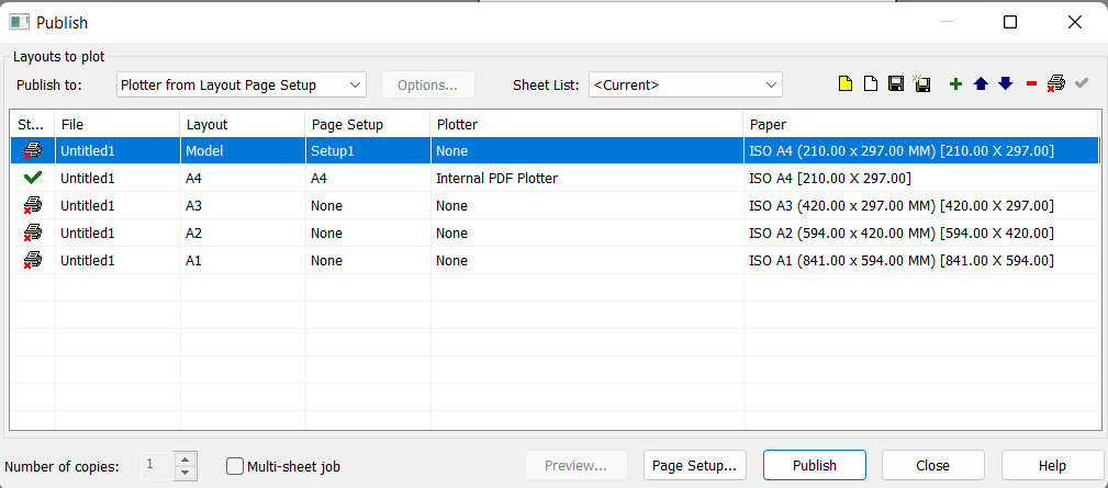

If the page setup presented in the previous section still seems too long, you can turn to batch plotting instead (Fig. 8). The PUBLISH command opens the corresponding window.
Fig. 8. Batch Plot dialog window
You can use this tool to:
- plot pages of several documents open in the program
- configure page lists independently and set their plotting output order:
- save page lists (.plst) and transfer them: Data% \Nanosoft\nanoCAD x64 XX\PlotConfigs
- set up the same plotting device for all pages. If any individual page was not assigned with a plot set, you will see a Plotting Complete (
) label across from those page names (
) in the Batch Plot window and they won't be plotted. To plot all the pages on the same device without additional settings, choose the plotter of your interest across the Publish to line on the drop-down menu list. The pages will switch from the status (
) to Plot Page status (

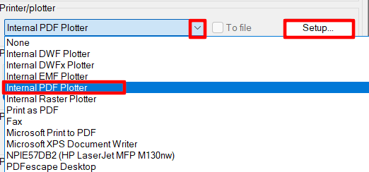

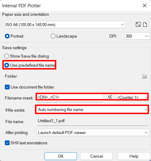

If you work with internal plotters (PDF, EMF, DWF, DWFx), you are familiar with the save document dialog window and the frequent notifications about multiple documents with the same name. Let’s create a counter to solve these problems.
- Call the PAGESETUP command (Page Setup Manager)
- Create an unnamed plot set
- Choose the Internal PDFPlotter in the Page Setup dialog window (Fig. 9)
Figure 9 Choosing the default PDF plotter
- Click Setup
- Change the following settings in the Internal PDF Plotter window (Fig. 10):
- Set up the Use Predefined File Name section.
You can choose any combination from the drop-down menu to configure the name for a saved document. Here’s how the file name template will look:
- In the If file exist field, select Auto-numbering file name
Fig: 10 Internal PDF Plotter setup
As a result of plotting three files, for example, we will get the names without windows popping up.

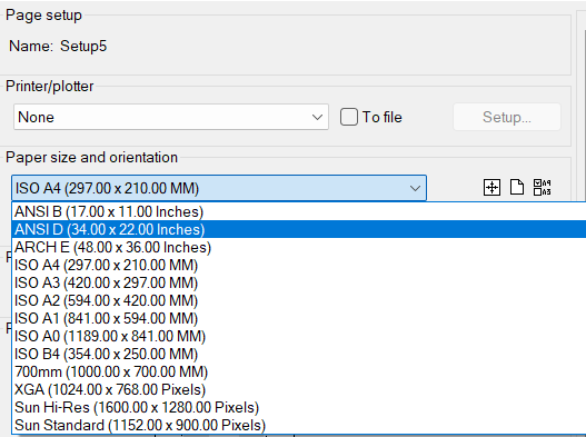

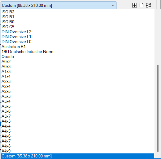

Tip 5: Editing the Paper Size and Orientation List
Fig. 11: Paper Size and Orientation list before editing

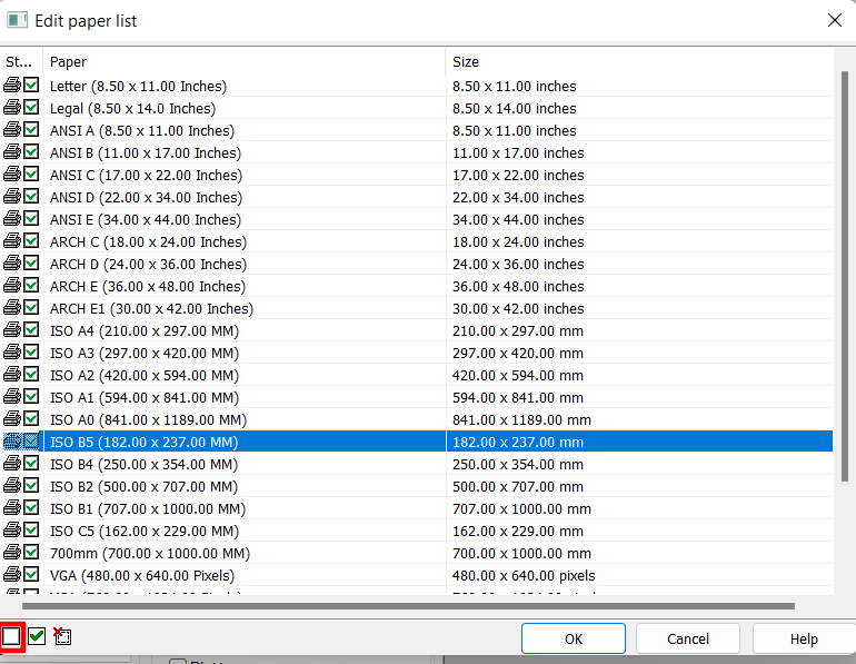

If you usually use the most common formats, since looking for any other format takes a long time (Fig. 11), don’t worry, the paper formats filter in nanoCAD will solve the issue in a couple of clicks.
Press the Filter paper button
in the Page setup dialog window (Fig. 12).
Fig. 12: Page setup dialog window
The Edit paper list dialog window will appear (Fig. 13).
Fig 13: Paper Format List Editor dialog window
Disable the formats you don’t need by pressing the Turn off paper button (
) in the bottom left corner of the screen. Formats marked with the
label cannot be deleted: they belong to the current plotting device. As a result of this cleanup, you’ll obtain a short list of the page sizes we need (Fig. 14).
Fig. 14: The Paper Size and Orientation List after editing

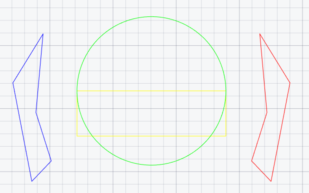

- We sketch random shapes with different colors (Fig. 15).
Fig. 15: Shape types before plot styles are applied

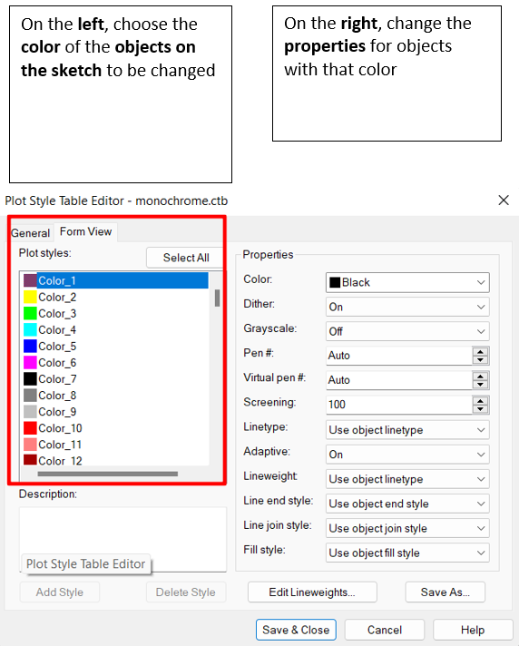

- In the Plot Style Table Editor, change the object properties as shown in Fig. 18.
Fig. 18: Changing object properties

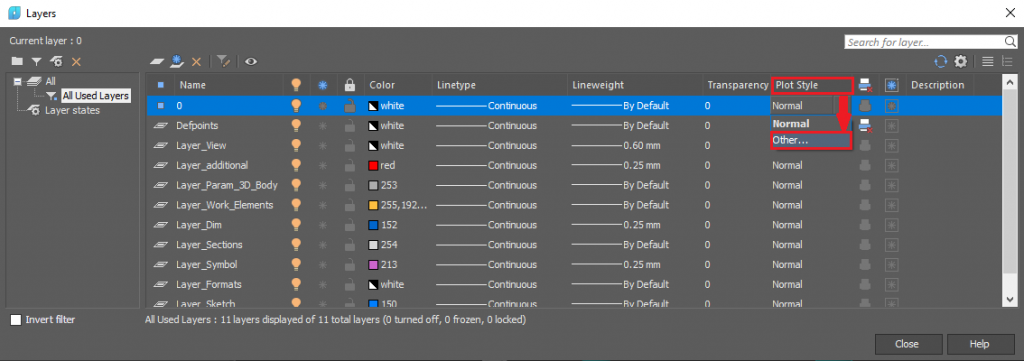

Go to the Layers (LAYER command) and choose the layer you want to apply the settings to (all objects on the layer 0).
Fig. 20: Layers dialog window

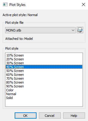

On the layer 0, choose Other from the Plotting Style drop-down menu (Fig. 20).
In the dialog window that pops up, choose the plot style file and the corresponding setting (Fig. 21). Click OK.
Fig. 21: Choosing the configured plot style

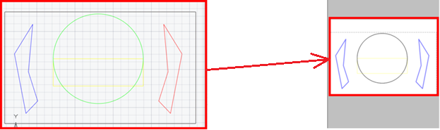

See the result in Fig. 22.
Fig. 22: Before (left) and after (right) applying the named plot style
