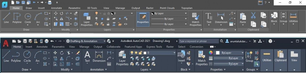

When migrating to nanoCAD, the first thing you notice is a familiar ribbon-type interface, similar to AutoCAD. Despite the visual layout, we will see some similarities in features in the first section:
User Interface
Fig. 1. Ribbon interfaces of nanoCAD and AutoCAD
Look at the user interface of nanoCAD through the eyes of an AutoCAD user. The first thing you see is the similar layout of command tabs and groups. For users who are more used to working with the classic interface, there is an option to switch to the classic interface in nanoCAD. Just click the top right button on the screen — Ribbon on/off Ribbon (see Fig. 1).

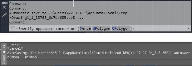

The command line is a panel designed to input commands using the keyboard. It also displays nanoCAD tips, system messages and options available for the running commands (Fig. 2).
Fig. 2. Command lines in nanoCAD and AutoCAD
The command lines in nanoCAD and AutoCAD look identical. For a more convenient view of the command protocol (or so-called command history) you can open a text box (a copy of the command line) by pressing the F2 key.

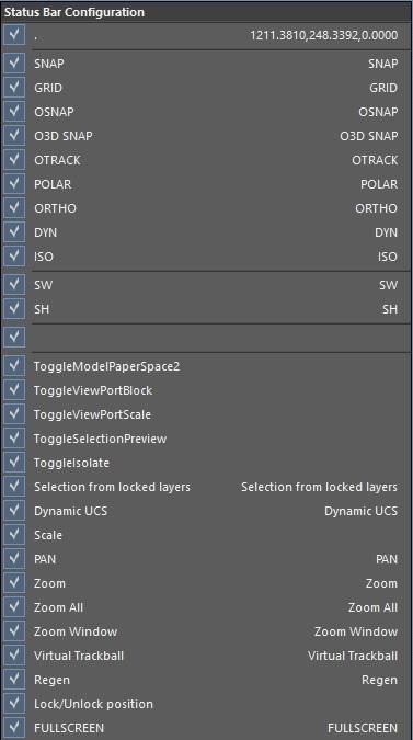

Status Bar
The status bar shows the cursor position in the coordinates and drawing tools. With the right click on the status bar you can open the contextual menu – Status Bar Configuration (Figure. 3), with a list of possible Status Bar elements. It allows you to fully customize the status bar by excluding/adding items through the context menu.
Fig. 3. Status bar context menu

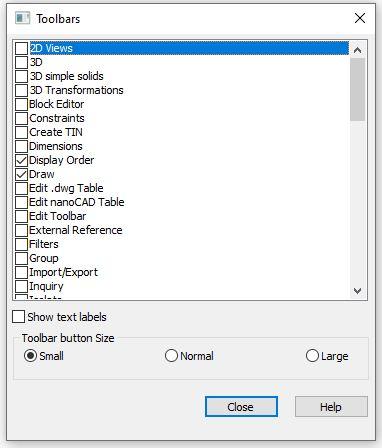

Toolbars can be added to both the ribbon and the classic interfaces. You can call the window with a list of available toolbars (Fig.5) by entering the command "Toolbars" in the command line:
Fig. 5. Toolbars window
In the window, you can choose the toolbars you want to add to the interface, as well as the look of the toolbars and the size of the buttons. Any custom toolbars you create are also added to this list (see “Interface Settings”).

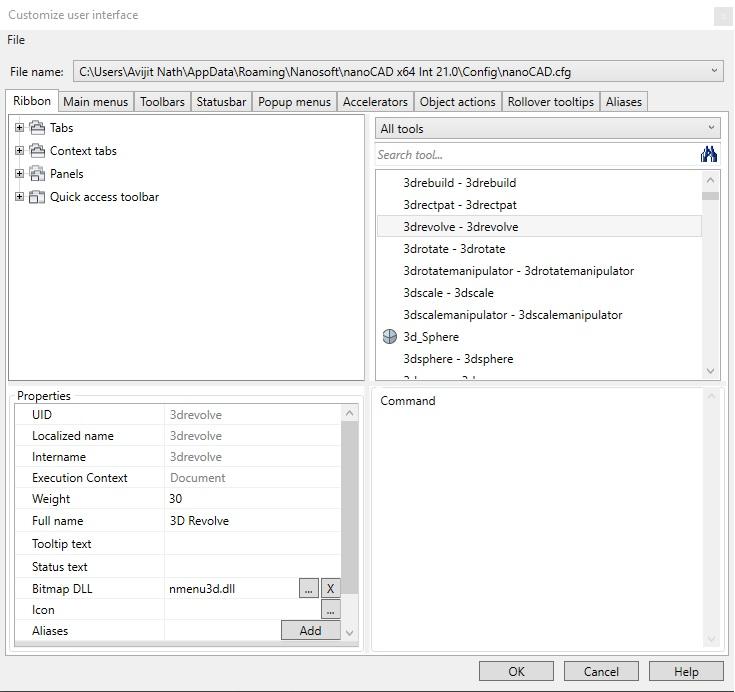

To open the Customize user interface window run the INTERFACE command (Fig. 7).
Fig. 7. Customize user interface settings
In the window, you will see the File tab that contains a list of operations with configuration files.
Customize window options
| File | Configuration file management commands:
| File name | The field shows the path and name of the edited .cfg file. The current configuration file opens by default. |
The window contains 9 tabs arranged in accordance with the command layout on the interface. The full list of the selected tab’s elements is displayed in the upper left window of the Customize user window as a tree.
In the upper right section of the window, you will see all nanoCAD tools, commands and controls to create and edit interface objects, such as menus, toolbars, and status bar.
You can filter the list for a quicker tool search:
- Dropdown list — select a category to display its group of elements.
 - Search tool — type the name to find a specific list of tools.
You will see the information about the item / action selected in the bottom right corner of the dialogue window.
In the Properties section (bottom left of the dialogue window) you can edit the properties of the selected items.

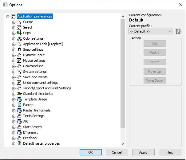

Program parameters settings include information about template usage, graphic subsystem, interface themes, and everything related to displaying objects in the model (cursors, grips, crossing frames, etc.).
You can find all nanoCAD settings on the same tab with the OPTIONS command. They form a tree of files for a quick search (Fig. 8):
Fig. 8. Options window
The information about the option's settings is stored in the registry editor. All changes that are included in the option settings dialogue can be recorded in the profile (Default profile) with the *.wip extension. Then, this profile can be easily exported / imported from/to other workstations.
You can set the paths of standard folders in the Standard directories section of Option settings. Read about each Standard directory in more detail below.

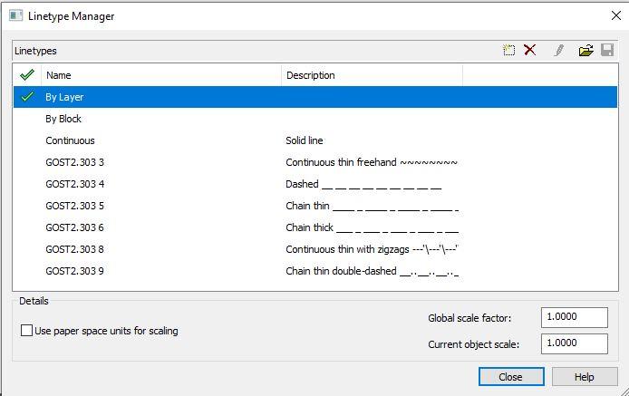

Line types can be loaded into * dwg and * dwt files in the nanoCAD interface:
- Go to the Home tab — Annotation Group — open dropdown menu — select Line Types.
 - In the Linetype Manager window select Load linetype (Fig. 10):
Fig. 10. Linetype manager window
The linetype file GOST 2.303–68.lin is installed automatically with nanoCAD. The linetypes from the file can be downloaded in the dwg files.

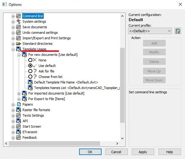

In the Options (OPTIONS command) choose a template usage (Fig. 12). This setting allows you to select desired templates from the standard Templates folder and display them as a list. When creating a new document, select a path for the template location, or use the default template (enter the default template file name).
Save a *.dwg file with specified parameters and styles in the *.dwt format to create a new template (Fig. 11):
Fig. 12. Setting up a Template Usage

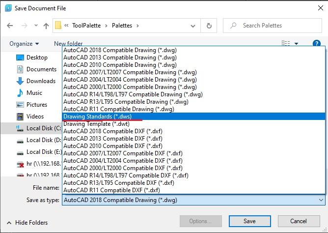

DWS Standards Files
The files in *.dws format are called Drawing Standards.
Standard files are not included in the nanoCAD. They are created by users based on project standards. To create a standard, you need to open a *.dwt template file with the specified parameters and styles, and then save as in the *.dws format (Fig. 13).
Fig. 13. Creating a standard based on DWT-template

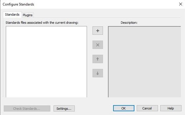

To link a standard to new files based on the DWT template, do the following:
- 1. Open the .dwt file and run the STANDARDS command
 - 2. In the opened Configure Standards window, click the "+" button (Fig. 14)
Fig. 14. The Configure Standards Window

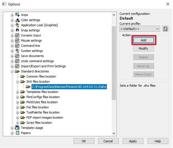

 - 2. "Software" — let’s see how it works on the example of SHX-fonts:
- Open the Options dialog box in nanoCAD.
 - Expand Standard directories to subsections.

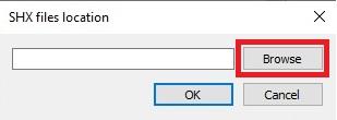

 - Select the "SHX files location" and click Add on the right (Fig. 15).
Fig. 15. Selecting Standard directories

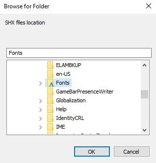

- Click "Browse" (Fig. 16):
Fig. 16. Window to add a Standard directory
- Find the Fonts folder and click OK:
Fig. 17. Browse for Folder Window
Restart nanoCAD to see all the downloaded fonts in the SHX and the Fonts folders (Fig. 18):

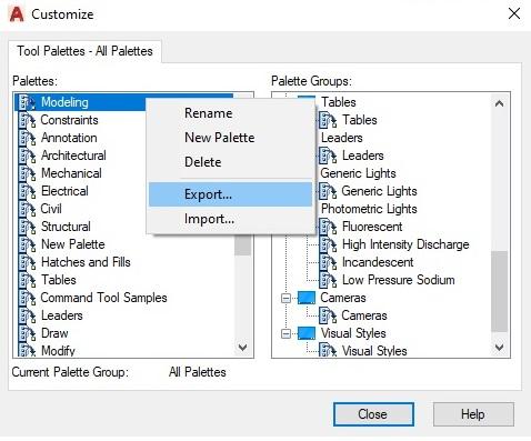

- Right-click on an empty space on the AutoCAD Tool Palette — select "Customize Palettes..." on the context menu (Fig. 19):
Fig. 19. Tool palette in AutoCAD
- In the Customize window, right click on the palette you need — Export... (Fig. 20):
Fig. 20. AutoCAD Customize Palettes

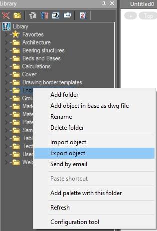

In nanoCAD, right-click on "Tool Palettes" - "Import palette..." (Fig. 21):
Fig. 21. Importing a Tool palette in nanoCAD
- Choose the *.xtp file.

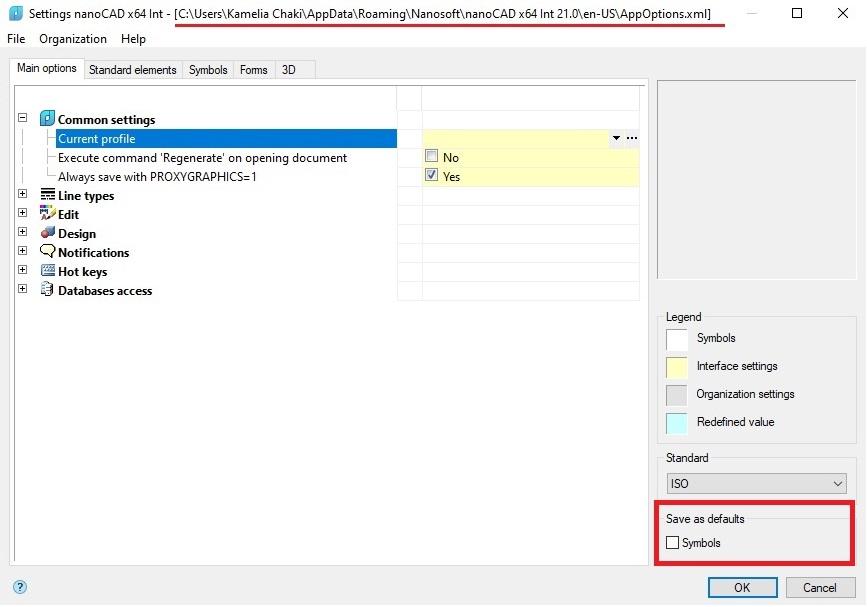

The design parameters are set in the Design Setting window.
Unlike in AutoCAD, nanoCAD design elements are customizable. You can change the Settings nanoCAD for enterprise standards. By default, all the design elements are configured in accordance with ISO.
To edit standard settings, open Design Settings - Main tab - Common settings
You can see the path to the current settings * .xml file in the window heading * (Fig. 22):
Fig. 22. Window for configuring nanoCAD elements
Check the box "Save as default" in the bottom right corner to save the settings between subsequent sessions of nanoCAD.
To transfer the design settings to other workstations, do the following:
- Open the "Settings nanoCAD x64 Int" dialog box, click "File" "Save settings as..." (Fig. 23).

- Open the Design Settings window, click on the “File” "Load settings”, and select the file.

In the Construction and Mechanica modules, you can add your own folders to the default folder. If you are using a network database, these folders can be easily transferred to other workstations, by selecting features in Configuration Utility for example, the "Publishing" feature.
- 1. Start the functional panel "Library" (the Tabs command – Library)
 - 2. Right-click on the desired folder and select "Export object" from the drop-down menu (Fig. 25)
Fig. 25. Exporting the Library objects
- 3. Specify the path to save the folder.
 - 4. * mcdi file is ready for import.
