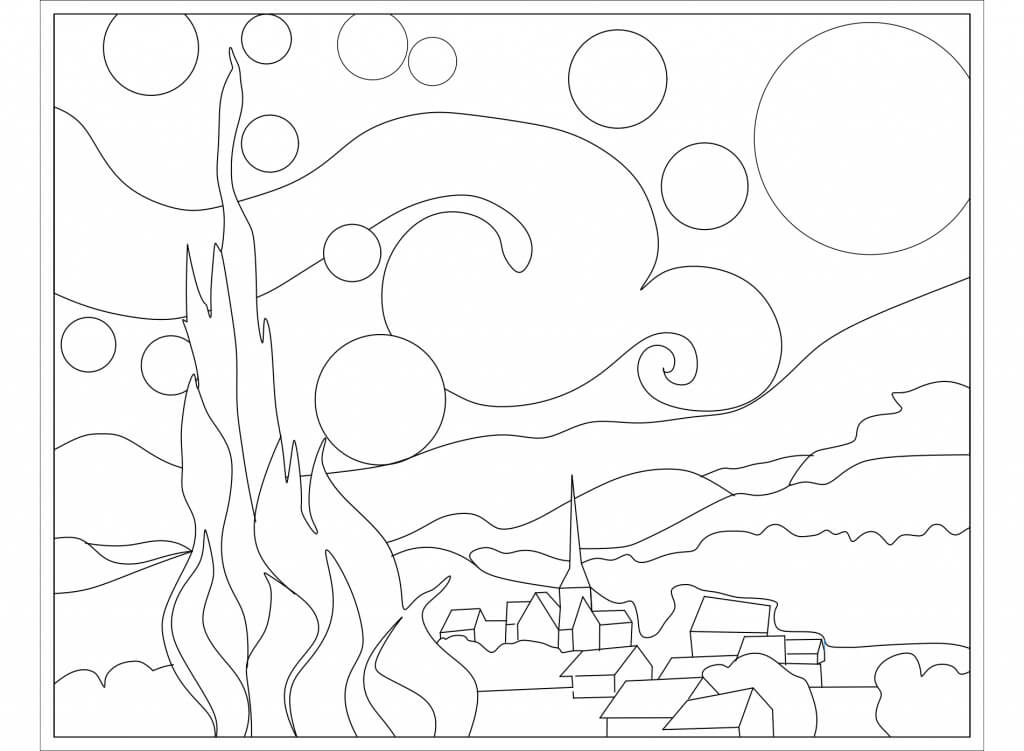

Let’s not dive too deep into the correct contouring and just insert splines (the SPLINE command) and circles over the picture (the CIRCLE command). Copy it to the clipboard (Ctrl+C) and paste it into model space (Ctrl+V). You can leave the contours open if your artistic mind is telling you so. Open contours can also be shaded.
Now we have our base ready for a future masterpiece (Fig. 3)
Fig. 3. The first stage: the basis of a future masterpiece

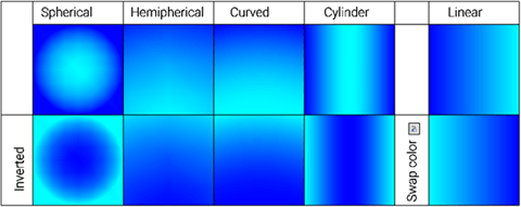

It is quite easy to use the Gradient tab. The image below shows a few examples of gradient fills (Fig. 6).
Fig. 6. Types of gradient fills

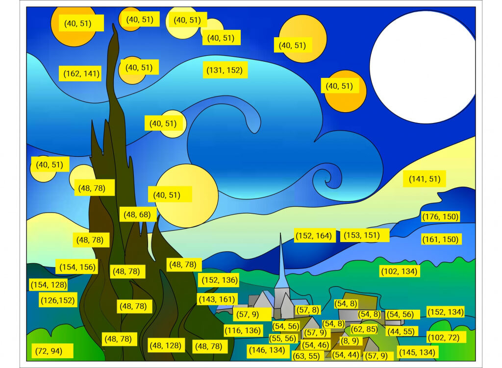

Here is what we’ve got so far with color numbers indicated in parentheses: fig. 7.
Fig. 7. Types of gradient fills

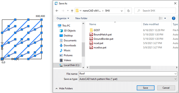

The nanoCAD Construction module allows you to create hatches using the SPHPATTERN command through the following steps:
Create sketch boundaries - a square with overall dimensions that do not exceed 300x300 mm. Place the bottom left corner of the square at the origin (0,0);
Sketch a single hatch element. The sketch should be done with the help of line segments only ( LINE command), curved sections are also approximated by line segments;
Each segment must be assigned a color;
Create an array of the sketch within the specified area. The final sketch must be a square matrix with at least nine elements to be identified correctly. If the line in the hatch is unbroken, it must be unbroken in the final sketch. In fig. 9 the red segments were multiplied by an array (nine segments - three columns, three rows, 100 mm between columns and rows), the blue segments were multiplied by copying (five segments) and cropping/extending to the sketch boundaries.
Fig. 9. The final view of the drawing for creating hatching
Each segment should not only be parallel to the segment of the same type but also lie on the same straight line with it.
Next, you need to select the hatch elements and call the SPHPATTERN command. Then, Save As and select a folder for saving (Fig. 10).
Fig. 10. Saving hatch pattern

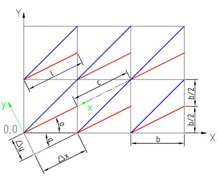

Let’s roll and create the "Roof" hatch using a text editor. As previously mentioned, the hatch record begins with quotation marks, followed by its name and comments.
On the next line, we will put one of the segments of the hatch. Let’s start with the red line. In order to build all the geometry quickly and accurately, we will place its origin at the point (0,0) of the world coordinate system (WCS). For illustrative purposes, we will place each identical area in a square with the length of “b” side 100 mm (Fig. 11).
Fig. 11. Hatch Geometry
The first two columns of the table are easy to fill: the angle of inclination from the OX-axis - α (up to four decimal places), the coordinates of the line’s origin are 0.0 in the WCS. The local coordinate system (LCS) is located at the starting point of the line segment, the x-axis is a continuation of the line segment, and the y-axis is perpendicular to the line segment. Select any of the nearest lines of the same name to define the offset. Let’s say, we select a line segment to the right of the starting line. Now we are in the LCS and define the offset of the first line segment: Δx=b×cosα, Δy=b×sinα, then the length of the line - l, and the length of the gap - c to the segment of the same name, lying on the same line with the first segment.
We will do the same for the blue line. The only difference is that the blue line is constant. Therefore, we don’t need to specify the lengths of the line segment and the gap. You can see the end result in Fig. 12.
Fig. 12. Description of line segments

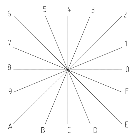

The shape number is unique within one “*.shp” file. The bytes contain information about the length and direction of the shape vector.
Each length and direction code is a three-character string. The first character is always 0 (it tells the program that the next two characters are interpreted as hexadecimal numbers). The second character specifies the length of the vector in drawing units. The length can be from 1 (one unit) to F (15 units). The third character specifies the direction of the vector. The correlation of code and vector direction is shown in Fig. 15.
Fig. 15. Correlation of code and vector direction
Use special codes to create additional geometric shapes (circles and lines). For the purpose of this article, we will use the most common codes. However, you can always use more codes from other resources. We have also added a table of special codes here (Table 2).

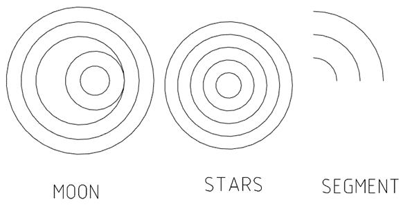

It is super easy to draw your own shapes with the help of this table (Fig. 16).
Fig. 16. Codes for "MOON", "SEGMENT", "STARS" shapes

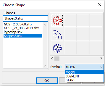

All shapes are located in one file (Shapes3.shx). Add the shape file to the SHX folder, then you will see the ”Choose Shape” dialog window (Fig. 17).
Fig. 17. Dialog box Choose Shape

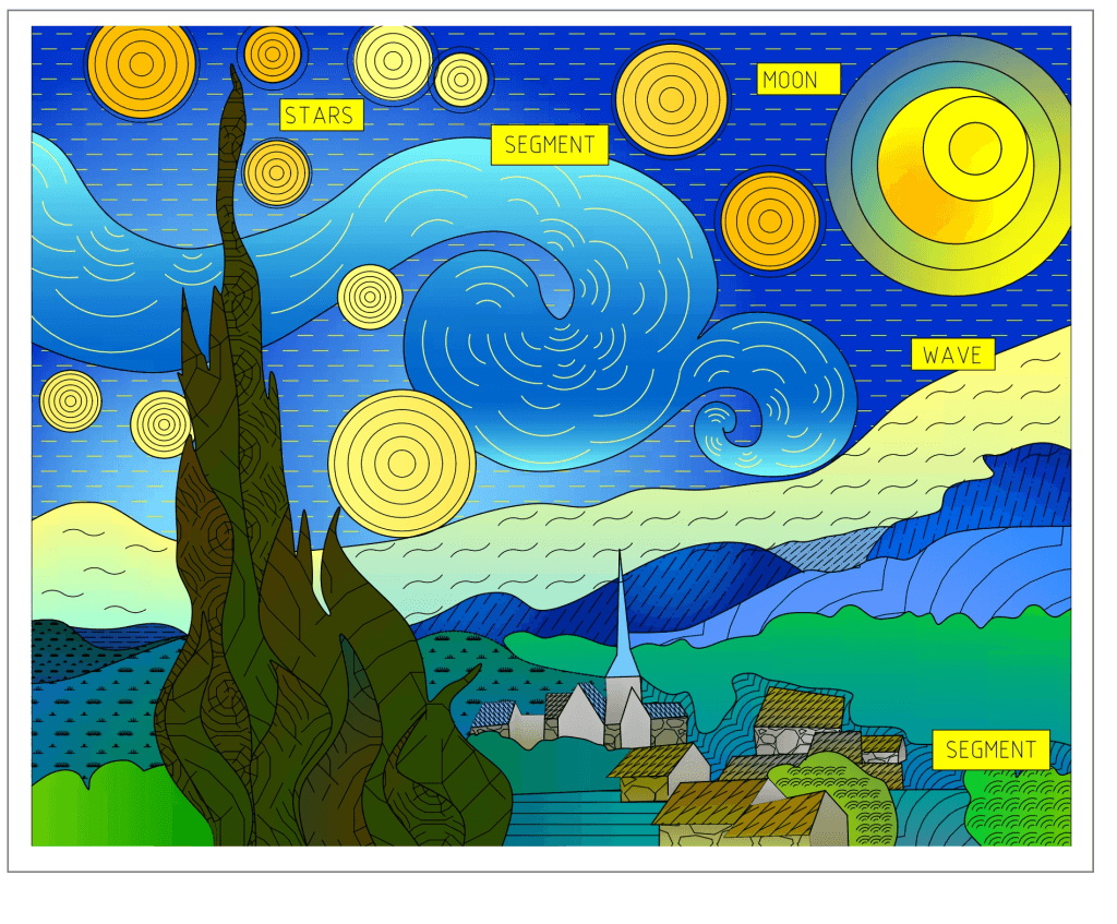

The whole process with shapes is similar to block building, except that you can select both the angle of rotation and the size of the shape when you insert it. Plus, it is possible to fill with a shape (Home tab → Draw Group → FillShapes), as well as with hatches, but without the Associativity option. Let’s fill a space above the horizon line with the standard WAVE shape from the GOST 2.303-68.shx file.

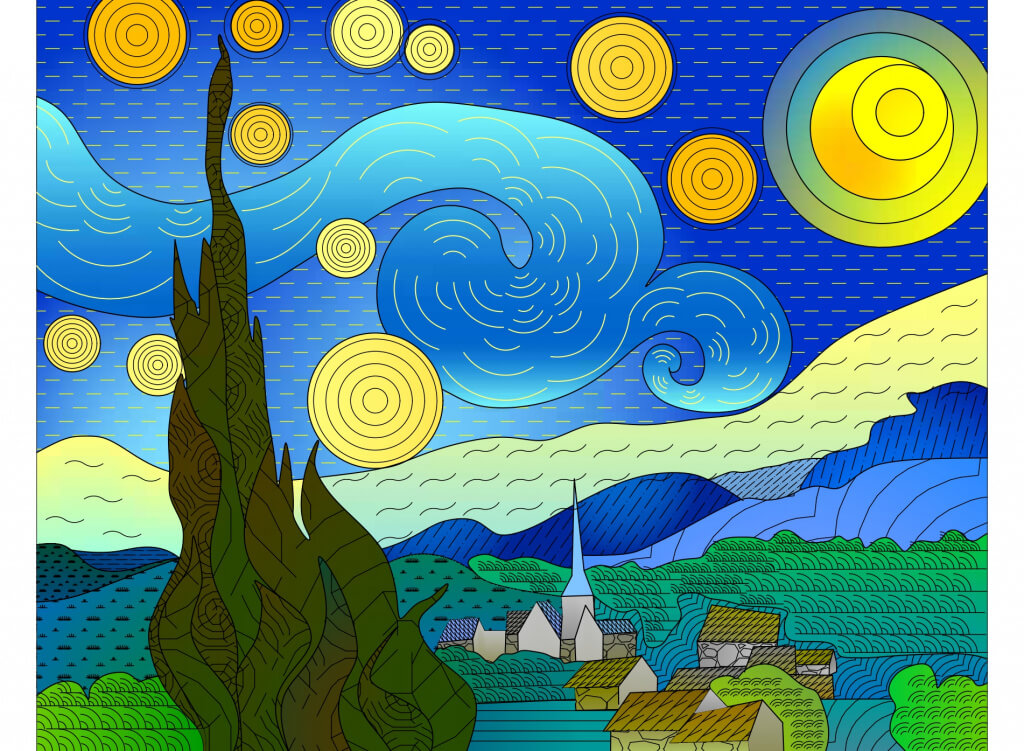

When the MOON shape is inserted, we can fill each circle of the moon with a different gradient (we can make it brighter to the center and darker to the edges). Check the final result of our drawing in Fig. 18.
Fig. 18. Fourth step: applying shapes
